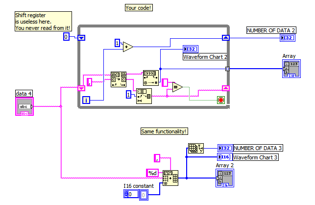

Well, your exclusively dealing with I32 integers (Actually, if your data is typical, all you need is I16! (4x less memory than your DBL). Now, if you would use a binary file, the file would be much smaller and reading it would be much, much faster!
Even if you want a spreadsheet file, you should stich with integers (use "array to spreasdheet string" with the desired type and write a plain text file and vice versa for reading).
The same coding rules I showed in my other attachment apply here too. You use way too many locals and sequences. None are needed!
Also many things can be dramatically simplified. For example look at your inner while loop. The entire thing can be replaced by essentially an atomic operation!
 See if it makes sense! 🙂
(for my alternative, I am using I16. Modify as needed).
