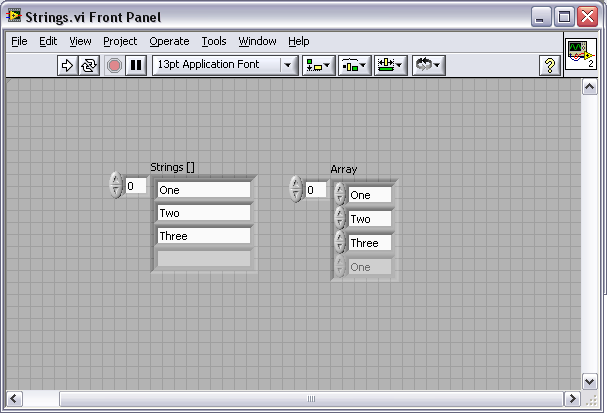

HI
could u please explain how to get to the propoerty node ring thingy as I cannot really understand how u transfered the contents of one array to the other one using the property node. Would be much appreciated if u cud post the VI.

See the attached pics to get to know how to create a prop node for a Ring inside an Array.

Thx heaps for ur prompt,clear and accurate response
