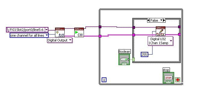

I have line 5 and line 6 within port0. I want to send digital output to line5 and line6 seperately.  How can I do that?
Currently, digital output will be written to both line5 and line6 at one time. What should the "DAQmx Write" be set to? Is it "Digital 1D Nchan 1Samp"?

If you want to write to the lines with separate data at the same time, change the enum to "one channel for each line" then use multiple channels, single sample (1D boolean) for a single write, or multiple channels, multiple samples for multiple writes (one after another).
If you want to write the lines at different times to each other (it sounds like you do) then create separate tasks.

Hi Cbutcher, thank you. I only have one device. Can it work with two DAQ tasks? I've tried two DAQ tasks, but errors come out.
(2,771 Views)
What error are you getting?  I have had A LOT of static DIO tasks with a single board.  So I know it can work.
