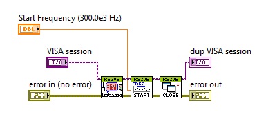

How can I set the frequency range via USB without losing the Network Monitor?
Hi, I have the Network Analyzer Rohde Schwarz ZVB 8.
My goal is to set the frequency range via PC and seeing the change on the Network Monitor. I implemented this simple VI:
The problem is that, after the running, I lose the Network Monitor and I cannot see if there was a change. I want, instead, to see the change on the Network monitor.
Can you give me an advise?
Thanks in advance.

Ciao Luana,
non ho ben capito cosa vuoi fare, da quello che si vede il tuo VI parte, setta la frequenza e poi si chiude.
Hai inserito un while loop prima di chiudere il task?
Valerio
