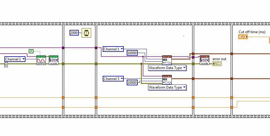

As shown in this picture of my code, where should I insert the signal VI?

the figure is part of the code. Not might how to set up a trigger after the measurement, the scope can't wake up? Could you tell which VI should use? Could you give me an example?

At some point you have to become familiar with the equipment you are commanding.  Even better is if you actually know how to use the equipment.  Read the manual, then select the appropriate VIs from the driver set.
Exactly what I was going to say. Assuming you know how to operate this oscilloscope manually, you follow the same basic steps in the same basic order to automate setting up and acquiring a waveform.
Also post your code, the actual vi not a picture. As I am betting that flat sequence structure is superfluous.

Thanks for your advice, the problem is solved, but not by using a trigger which can't wake up the scope.
Message 9 of 13
(4,199 Views)
Problem is solved. The flat sequence structure just for making each part looks clean when I try to design a new code.
