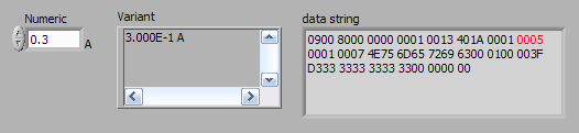

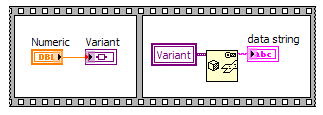

Hi schaerm,
you have to dig deeper.
An idea is this one:
The red marked word is containing the unit - in a coded way. Somewhere in the LV help you can find the description of this coding (I remember a chapter on memory representations of all LV datatypes...). (There surely is an easier or better way - but the example is done quic&dirty.)
You can also format the number into a string and analyze the unit here...
Message Edited by GerdW on 02-07-2010 07:21 PM

Thank you GerdW!
The variant solution works perfect!
(LV does not allow to format a number with unit to a string)
Best regards Mark
