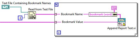

I am having a similar problem were my inputs are more than 17, and  I am actually using the recommendation of Darren of Append Text. The problem now is that I have more than 366 bookmarks can I consider making individual Append Text Vi for each bookmark in these case too extensive, Is there a more efficient way to reduce the programming load?

If you have that many bookmarks, I think it makes the most sense to keep the bookmark names in a text file (or XML, or whatever), and use Append Report Text.vi in a loop to apply certain values (I really hope those 366 values you have are in an array!) to certain bookmarks.  Here's a mockup of how that might look:

Hi, I am quite new to Labview (just been using a couple days) and I was hoping to do something along the lines of what you have posted here.
But I can't figure out how you create that bundle with the singular Word Bookmark object type outside of the MS Office Parameters class. Can you clear up a little how to create that bundle (or any other for that matter)?

Actually, I figured it out (just connected the class definition to the structure and connected the one string in the bookmark space). It doesn't look as nice as yours though, I'm interested in how you got that collapsed form.
In LabVIEW 2010 and later, you can right-click a cluster constant on the diagram and choose "View Cluster As Icon".  Another way to collapse it is to double-click the cluster border.
