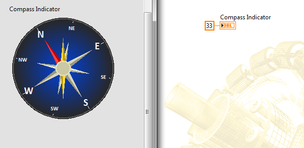

How can I use the compass indicator from Robotics Module?
I need to use the compass indicator from Robotics Module.
I would like to know how to pass a value to it? What is the range?
Thanks in advance

It's a numeric indicator, where the input is in degrees.  0 degrees is north, 90 is east, 180 south, etc.
