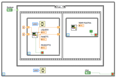

I managed to do it with a flat sequence, gonna also try with the error i/o dataflow and see what fits my case more.
My only problem now is that i have all of this in a while loop to make it run repeatedly, but it just doesnt happen (only runs one time), any idea why?
Message 5 of 9
(2,387 Views)
Hi
I think the problem is, that the second loop has a false constant wired to its stop condition. It runs endlessly.
If you make it a true constant it should work.
Message 6 of 9
(2,370 Views)
problem is, if i make it a true constant, the first subVI will start running again instantly, during the time the second subVI still runs, which i dont want to
Message 7 of 9
(2,358 Views)
No, this is not true! VIs are executed one after the other. Use Highlight Execution to see better what's happening:
Lucian
CLA
Message 8 of 9
(2,351 Views)
Having now seen your code I would suggest that you learn about state machines. With a state machine architecture you can accomplish this task with a single loop - no need for getting stuck inside of inner loops or finding ways to program around that. I've attached what that could look like with your example.
