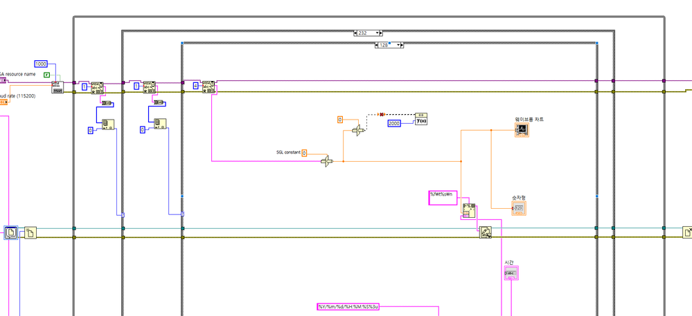

Hi, I want to FFT my real-time DAQ system.
I attach my program.
I refer to below design.
My DAQ's Fs=2000Hz
Data is acquired Every 0.5ms.
But I don't know how can i collect data to 1-D array.
I haven't been learn about Labview array......... T.T
Please help me how can i do that.
(3,191 Views)
You get one point at a time and the fft of that is not interesting. (I don't think you understand the typecast function).
Accumulate your values in a shift register or use "fft ptbypt".
(3,172 Views)

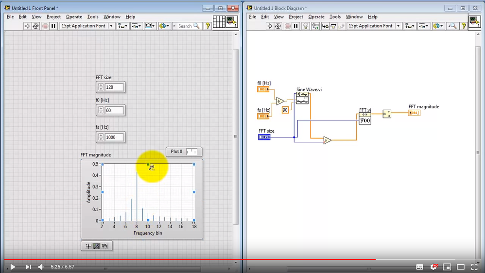

I also think you should spend some time to learn about LabVIEW and data acquisition.
Here are some links for you.
Tutorial: Arrays and Clusters
https://www.ni.com/en/support/documentation/supplemental/08/labview-arrays-and-clusters-explained.ht...
LabVIEW / Array / Shift register
https://www.youtube.com/watch?v=IyO-OyOCh8k
FFT Example From Single Input Data Using LabVIEW
https://forums.ni.com/t5/Example-Programs/FFT-Example-From-Single-Input-Data-Using-LabVIEW/ta-p/3526...
