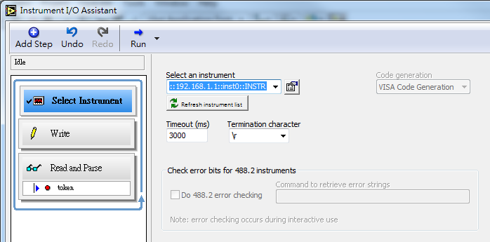

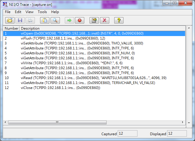

Update...
I tried to use the Instrument I/O Assistant to verify this problem.
In the Instrument I/O Assistant, The connection is working properly.

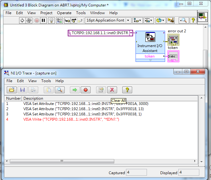

But, After finish the Instrument I/O Assistant, Back to Block Diagram,
The VISA Write Error is shown up.
Convert the Instrument I/O Assistant to VI component.
The VISA Write Error is still showing up.

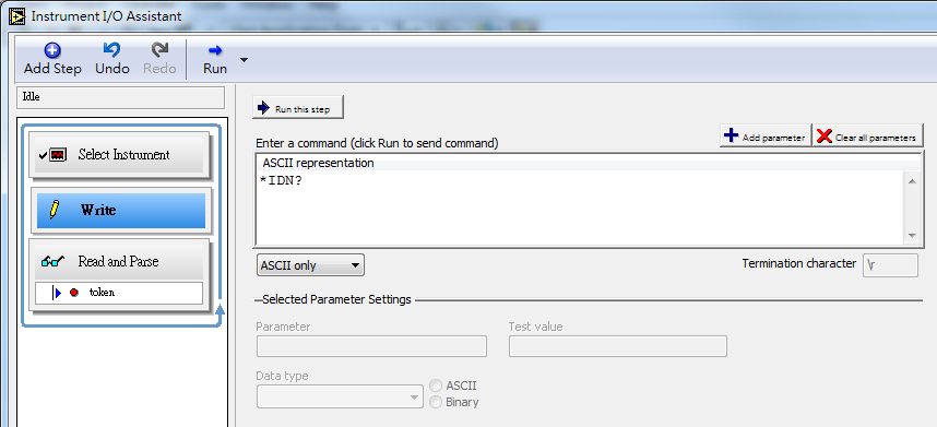

Step1: Add the step : instrument source, write, read and parse.

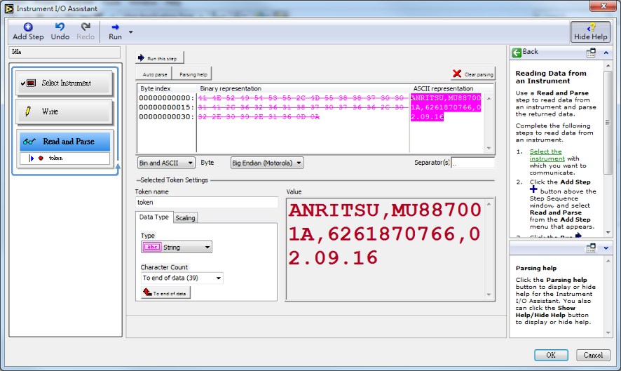

Step2: Verify the SCPI Command. "Wirte" and "read and parse" ("queries" also work!)

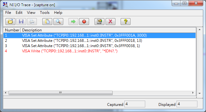

Step3: In the NI I/O Trace, The command and response is normal after execute above the step.
Step4: After finish the Instrument I/O Assistant, Back to Block Diagram, The VISA Write Error is shown up.
Step5: Convert the Instrument I/O Assistant to VI component. The VISA Write Error is still showing up.
Step6: In the NI I/O Trace, Found a VISA Write error after execute above the step.
Until now, The status of VISA Write issue is below:
1. NI MAX => working
2. IN the LabVIEW Block Diagram => not working
3. Instrument I/O Assistant => working
4. In the LabVIEW Block Diagram after finish the Instrument I/O Assistant => not working
5. Convert the Instrument I/O Assistant to VI component in the LabVIEW=> not working
Message 27 of 35
(3,673 Views)

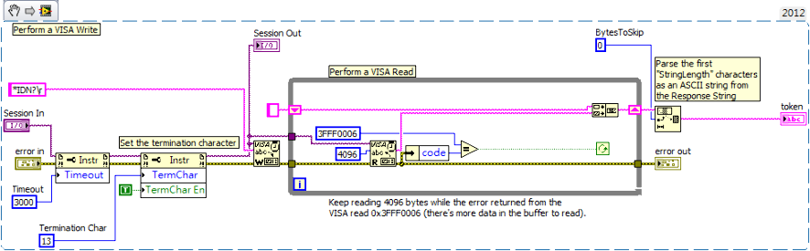

Are you sure that constant *IDN?\r is in '\' Codes display mode?
Edit: I've seen you using two different term characters.  You might want to verify you are using the correct one.
