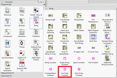

I found a work around. In the string folder, there is a string Line Feed Constant. I combined it at the end of the write command (the write command does not have "\n" anymore). I made sure that VISA was not sending any additional end Characters as well. This sent the correct write string to my instrument, and it responded as expected. The read portion did not show any errors after these changes either.

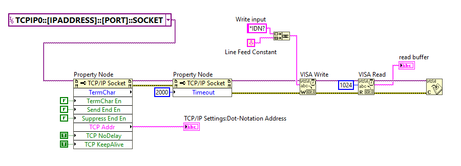

Below is a snip of the VI I have made that is currently working for me. I will make changes to the VI to tailor it to my needs, but I hope this will be helpful to anyone that seems to have this issue.

Actually better yet: Right click on your string constant and select "'\' Codes Display".
Et voila!👌 Now you can enter your \n in the string and it is sent as 0x0A character code.
And to make things even nicer, right click again and select "Visible->Display Style". Now you see a glyph at the left side of the string constant/control that indicates what display style the string is currently using.

Thanks, I did that and it cleaned it up a little more!
