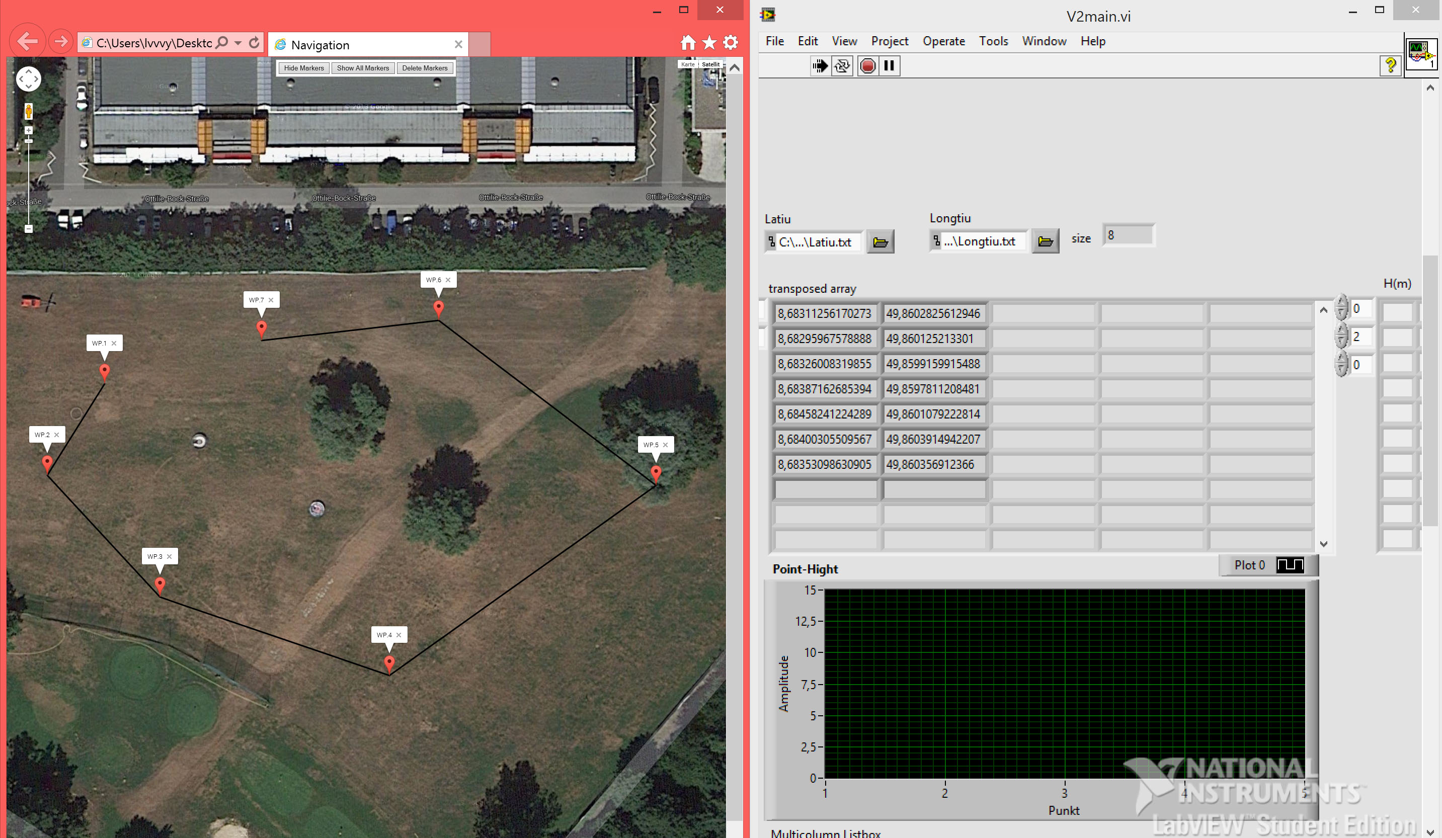

At moment i use javascript to creat a google map DOM. It could build two txt.file with latitude and longitude. Labview can read those txt.files and get the position(like the picture). But this map Dom can only be used in IE explorer, because i use ActiveXObject (JavaScript) to creat the txt. So it is possible, that this google map DOM direct be loaded by labview, like use ActiveX? Or some better way to read the Position from google map?

Your picture does not show.
(3,536 Views)
thanks for your reminding. this is the  picture.
(3,521 Views)
You can use .NET Nodes to interact with GMaps in LabVIEW, here there is a library that could be useful for you: http://greatmaps.codeplex.com/releases/view/20235
And a complete example: https://decibel.ni.com/content/docs/DOC-7983
