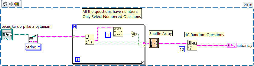

Hi bury,
using LV2018 you can even apply Shuffle on your string array of items, so no need for an additional loop as I described before:

Try this. And next, start your homework earlier. Create the VI yourself, you will learn something even if you just copy it exactly.
