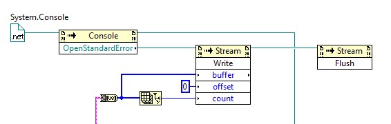

an old thread I know but wanted to share this howto use a LabVIEW executable with SystemExec
- pass your command line arguments by using the LabVIEW Application Property Node App.Args
- write to std out using System.Console.WriteLine
- write to std err using System.Console.OpenStandardError (string2byteArray, see screenshot)
This solution is pure .net and works for 32 and 64bit systems.
