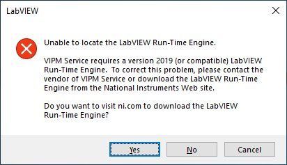

         I am no longer in need of Labview on my computer so I fired up the uninstaller and attempted to uninstall all the NI software. The process took 4 hours, but I thought it was gone.
After that, every time I boot-up, I get this error message (See below). I went through the start-up menu in windows, I went through the registry, I went through Program Files, Documents, every place I could thing of and removed any trace of National Instruments software, or references to the software, but I kept getting this message.
      Can someone please tell me what I missed. Thanks in advance.

There is a separate install of a program called VI Package Manager, from a company called JKI.  Uninstall that.

That did it. Thank you. Tricky devils. They used a shell company. 🙂

I used the uninstaller that NI supplies to Windows. I did it by the book. It took 4 hours, and it ran to completion.
However, the uninstaller is the worst I've ever seen. It left NI remnants all over my computer, and I was getting that annoying error message every time I would boot my PC.
I didn't know that the VI Package Manager was not an NI program, so I didn't look for it. It was someone else on this forum (bless his heart) who pointed to that program. After I uninstalled that one, the problem went away. Thank you for your message.
