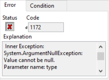

I have tried all of the methods on here and none of them work for me.  I get Error 1172 which I believe is telling my that I am passing a NULL type to the Activate Invoke node -
Is the string typeName that I have listed invalid?

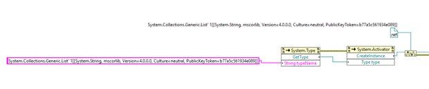

have you seen message 15 (https://forums.ni.com/t5/LabVIEW/How-do-I-create-a-NET-List/m-p/3089679#M883437 ) in this thread?
There should be no space in between: System.Collections.Generic.List`1[System.String]
From your picture it seems there is a space in the string.
Message 23 of 30
(3,434 Views)
There is indeed a space in the string, as you say.  I get the same with and without the spaces, both in the type name and also within the parameters in the square brackets.  I have also have the same problem when I include just [System.String] instead of the full list of parameters in the square brackets.  I think I have tried all combinations for the string format and nothing solves my problem.   Still seems like the type name cannot be found.  Any other ideas?  I am using LV 2017 SP1, BTW.

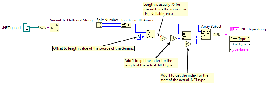

Assuming that the .NET reference constant you have there is a null instance of the actual Generic list you need to create, there is a way to extract the .NET type string programmatically in LabVIEW using the Variant to Flattened String function:
You could try that just in case there's something different about the type name you need to use on your system compared to the constant string you made.

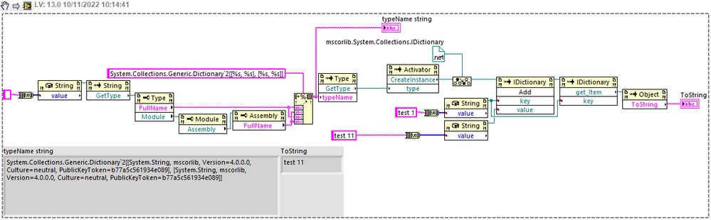

One thing that's important to note is the apostrophe after the type is not the standard one (0x27) but one with the ASCII value 0x60. I'm guessing this is your issue.
Another point is that you can get the assembly info for the internal type using .NET, which should make it somewhat safer. See this example for a dictionary, which has two internal values, but it should be the same for a list:
