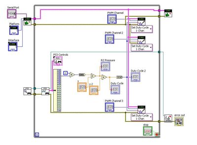

Here is the current VI.  I am new at this so it mught look rough.
Thruster VI

Is the throttle setting the floating point value derived from the big unbundler? If so you could use a running average to limit the rise and fall times.

Or you could insert logic to limit increases and decreases to a specific amount. A shift register would hold the current level which would be incremented by the smaller of two values: the commanded level or the max allowable increase.

It looks from your picture that you simply have a greedy while loop that needs a simple wait inserted in it.  I don't have 2014 installed on this machine so I can't look at your code to verify my assumptions.
Replace that unbundle with "Unbundle by Name"  and get in the habit of always doing it that way (you'll have a lot more years before you need a toupee)

Whatever you do to slow down the rate, and I think Jeff's solution is the easiest, you are going to slow down the response from the ps3 controller and the rov control might be quite jerky. If that occurs and is unacceptable, you might want to consider a different esc.
