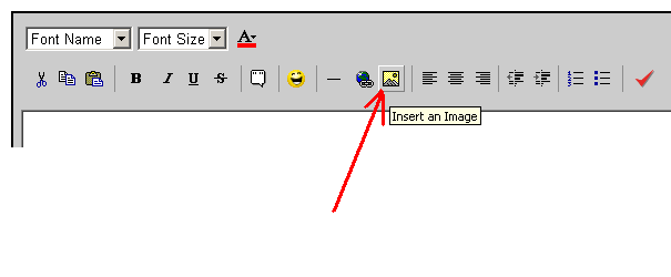

First get the URL of your image. If you have not posted it yet, attach it as you did previously
post the reply then click on your attached link and copy the URL
quickly (5 minute limit on edits) return to your post and edit it.
When editing click the "insert an image" button
paste the image URL into dialog box.
submit edited post.
Again, thanks for sharing your findings!
