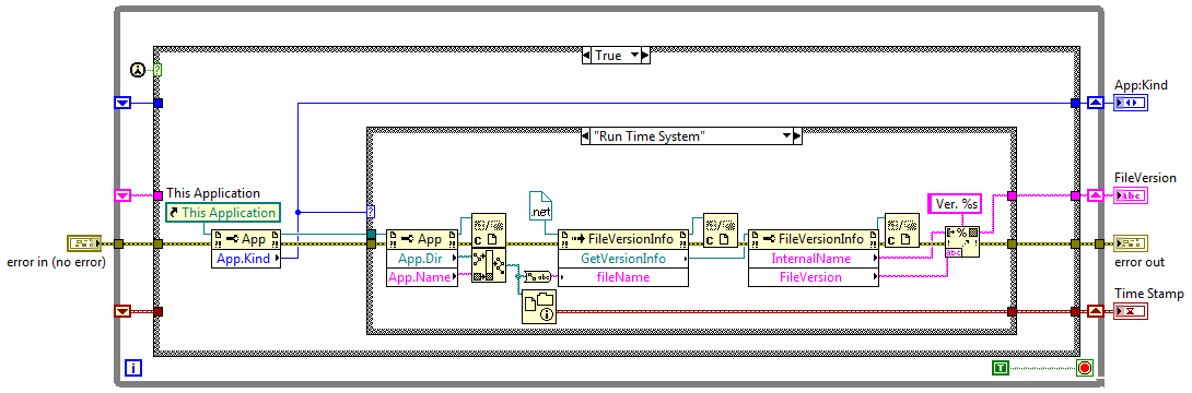

I usually keep tis AE in my reuse library.

Funny-  I thought that would post snippette-wise (Funny doings with the firewall here)  Updated to silver

Hi.
Thanks for your responses.  I ended up doing a hybrid of the 2 solutions offered and got it working.  I am surprised that this is so hard to do.
