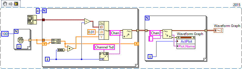

Since I dont want any of my mentors especially, Bob and Altenbach to get fed up with me i have attached a  vi this time ๐Ÿ™‚ ๐Ÿ™‚
Attached VI shows a combination of the two attempts (first with the waveform graph and second with the cluster graph)
1. With the first (waveform graph) i get my channel names as desired, but the alignment of the waveform is not correct.
2. With the second (Cluster graph) alignment is right but i cant get the channel Names into the graph even though they are present in the cluster.
I have read up some write-ups which mentioned that attributes can only be displayed with waveform and dynamic data (not clsuters) so i guess thats why.
I have also seen another write-up that says the start time of a 1D waveform will always remain the same for the rest of the rows as defined for the first row even if changed for the subsequent rows in a loop.
So i guess my question is: what is the way around issues like this?

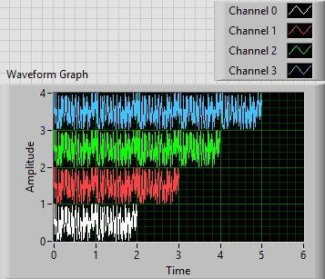

  1. Generated a 100-sample random array to represent 1 second of a waveform.
  2. Created 4 waveforms based on this 100-sample base.  The first Waveform (Channel 0) is just these 100 points.  The second, Channel 1, is the concatenation of Channel 0 with the 100-sample base, or a "double" waveform.  Channel 2 is Channel 1 concatenated with the base, and Channel 3 is Channel 2 concatenated with the base.
  3. In order to plot the four channels so they don't sit "on top of" each other, the Waveform has the Channel number added to it.  Thus Channel 3 is 3 + (4 copies of the base 100 points), a 400-point random waveform centered around an offset of 3.
  4. All Channels have dt set to 0.01 (though I suppose I could have varied this, as well).
  5. To make the channels start at different times, I started Channel N N seconds before Channel 0 (by subtracting the loop index, i, from t0).
  6. For each Channel, I created an Attribute called "Chan" equal to "Channel N" (where N = 0, 1, 2, or 3, as appropriate).
Here is the resulting Plot. The X Scale is set to Absolute Time (no Date) using the 24-hour HH:MM:SS format.  You can see that the plots are 1, 2, 3, and 4 seconds long, and are offset from each other by 1 second.  I used the Plot Attributes to change the Plot Names to the respective Attribute.
The code to do this is extremely straight-forward -- I almost don't need to show it, as I think it is completely described by the text above, but here it is:
Now, wasn't that much quicker than some of your previous posts, where you refused to post your code, we "guessed" at what you wanted (but didn't guess correctly), you tried to "nudge" us in the right direction (still refusing to post code), and noone seemed very happy?

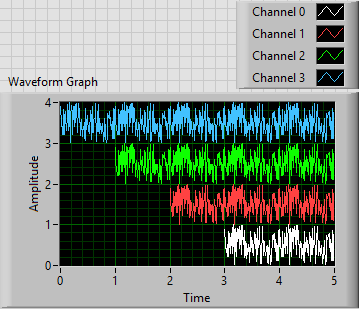

I started with my previous Demo posted on this thread, and turned on "Ignore waveform timestamp on x-axes".  The Plot looked the same, each plot origin being offset.  However, if I also turned off "Ignore Time Stamp" from the Front Panel properties of the Graph, I got the following:
This, of course, makes perfect sense, as the four Channels are constructed to have different lengths, and we turned off the "align according to the value of the X (time) Axis", hence they all start from the same X value and merely plot as many points as there are in the Channel, hence they end at different times.  So all we have to do is to align the Waveforms at their end points.

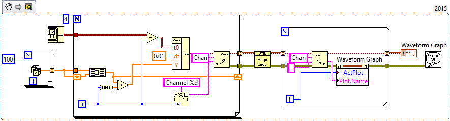

Here's a revised Demo (I used the earlier Snippet, changed the Graph to make the above plot, then added one extra sub-VI, as shown here):

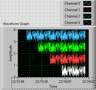

and here is the resulting Graph (I added the Simple Error Handler to ensure there were no Errors, which returned "No Errors"):
Don't worry that the plots look slightly different from the graph above -- these are, after all, Random Numbers ...
