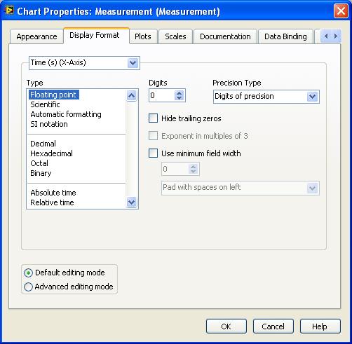

I am trying to format the x-axis so that it shows time in seconds, as opposed to the current format in which it is. I have tried tweaking the format option to display as <%S> but it still is not correct.

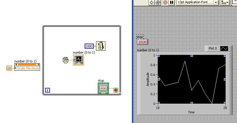

The VI and a sample graph with the current 'second' scale is attached.

Hi msmartei,
Firstly, have you seen this knowledgebase article?
Displaying Current Time on a LabVIEW Chart
http://digital.ni.com/public.nsf/allkb/6F0054EEABAFE4B886256F2700012142?OpenDocument
These properties allow you to display time fine, it works for your chart.
 You can then use property nodes to alter the start value, displayed range and maximumn values for example. You can also edit the color, style of the plotted lines for example.

Hi Hillman,
Thanks for the reply and the knowledgebased article.
I tried it and it seems to work fine. Is there anyway of ensuring that the update occurs in realtime seconds, i think that the current rate (i have the multiplier set to 0.001) is a bit on the fast side. Do i just have to tweak the update rate?
Margaret
Message 3 of 8
(8,964 Views)
Your output labeled Actual Input Rate should be used with the Reciprocal functions. Then, if you change the sample rate, you don't have to change anything else.

How many plots do you want to save. Right now, you have the chart history set to the default of 1024. The front panel number of samples is set to 500 so you will display slightly more than 2 iterations at a time. You can increase the history size to show more.
