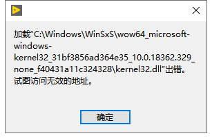

Why does it show an attempt to access an invalid addressQQ截图20200530001145.png

The Win32 API is still fully functional and accessible unless you run on a Windows IoT (non Enterprise) platform.
Both VIs work fine on my computer using Windows 10 and LabVIEW 2018.
The problem is likely that the library path got somehow messed up. There should be ONLY kernel32.dll and nothing else in the library path box. Also I have no idea why the name of the variable got localized. They were standard ASCII characters and should not be renamed no matter what locale your computer is using.
Ohhh you didn't download the VIs in the links I provided but created your own. A LabVIEW string handle is NOT compatible with a LPSTR pointer. Download the VI in the second link and use that instead of trying to do your own experiments when not understanding the C datatypes.
