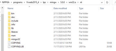

I recently had the same problem.
The fix was to copy the new MinGW files over the top of the existing ones, and choose "Replace" where the same files exist. Removing the existing contents and replacing with the new version doesn't seem to work - so there must be some files in there that need to stay put.
The folder I replaced was "C:\NIFPGA\programs\Vivado2014_4\tps\mingw\5.0.0\win32.o\nt" for LabVIEW 2015 Vivado tools. Only performed a basic install of the "mingw32-base" package. IP Integration now working fine.
Hope this helps.

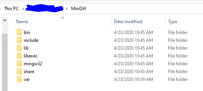

Sorry for re-opening an old topic.  My work PC was refreshed to Win 10, and I am responsible for managing a LabVIEW FPGA 2017 SP1 design.
The target device is the PXIe-7971R FlexRIO card, and when updating the Socket CLIP, I have run into this same problem.  I've attempted to follow the solution provided:
1. Get the latest MinGW installer from their website.
2. Install "mingw32-base-bin (shown below) by checking the box, and applying changes.
3) Copied all of the directories as shown from c:/MinGW
to the following folder, overwriting all conflicting files.
4)  Open LabVIEW 2017 SP1.
5) Re-open my project
6) Open Properties for my FPGA, and choose "Component Level IP"
7) Create a new CLIP - follow the usual config for my system along with adding the .vhd and .xdc files.
Receive Error:
Error 1097 occurred at Call Library Function Node in niFpgaIPINodeGetPortsInfo.vi:2590001->niFPGA_ClipGenerator_DoFuse.vi->niFPGA_ClipGenerator_WizardPage3.vi
Possible reason(s):
LabVIEW: An exception occurred within the external code called by a Call Library Function Node. The exception might have corrupted the LabVIEW memory. Save any work to a new location and restart LabVIEW.
Have I skipped any steps?  Has anyone seen this similar issue when attempting LVFPGA 2017 + Vivado 2015.4 + Win 10?
Thanks in Advance,
J
