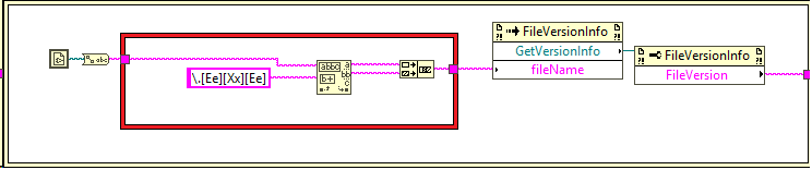

Nice jmcbee !
And this is modified. It's more handy
(19,169 Views)
