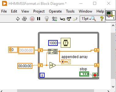

How do I get the numeric format (HH:MM:SS) in an array? I have attached my code.
I built an array and I would like the number being fed into the array to be in hour/ minute/ second (HH: MM: SS)?
I've tried it, but it did not work. Can anyone please help?
My code:
The results on the front panel that I don't like:
Can someone please help?

Hi GRCK,
you should have learned by now: when you need a specific display format in a FP element then you need to configure that specific display format in that FP element!
You also should have learned by now: even though you apply a specific format to BD constants it's still the DBL datatype with the same DBL values inside the shift register. Th eindicator on your FP doesn't care about properties of BD constants, it only receives the value…
Did you set the display format of the numeric element inside the array as needed?
(1,586 Views)
Thanks GerdW! Yes, I should've known this by now. smh 😑. But It works now; I updated the array on the front panel to the same format.
