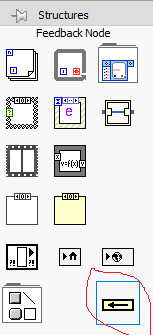

Hi ,
You have used subtraction , division blocks . Can you tell me the name of that other block in the image?
Thank you !!!
Message 6 of 10
(8,901 Views)
"feedback node", it's the same as shift register in loops
