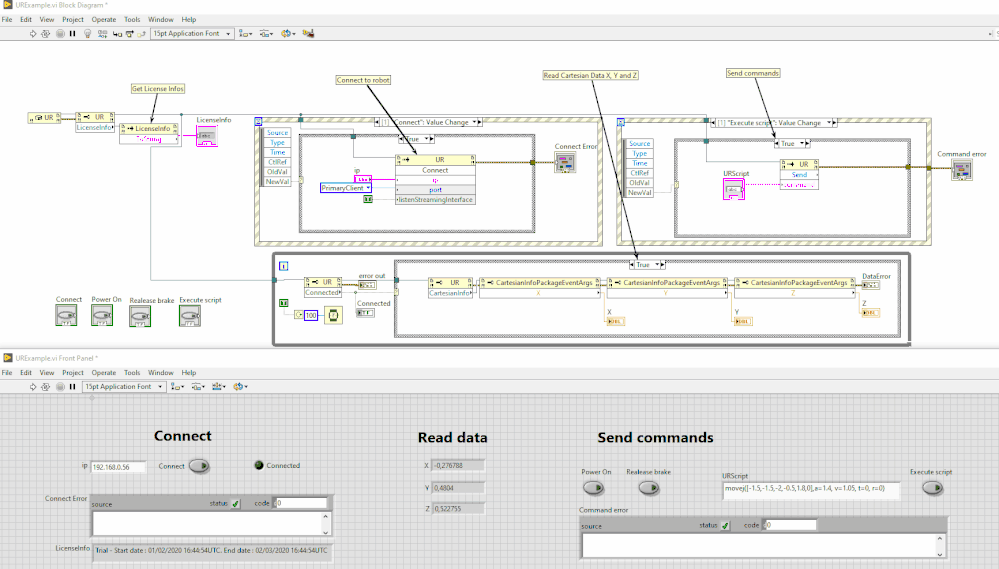

This SDK has a ready to use LabVIEW example to remote control and read robot data : https://underautomation.com/download/#labview-integration
You can read the SDK documentation to see all features. You can then adapt the LabView example for your needs.

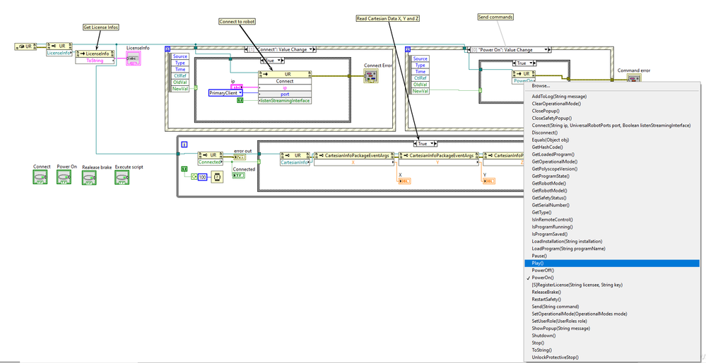

Yes, with the VI example, you can control a UR3e. The machine that runs LabVIEW and the robot should be on the same local network.
The given VI is a small example. It allows you to remote power on the robot, release brake and remote send a line of UR Script. But, you can customize this example for your own needs.
All features are located in the DLL \Libraries\net40\UnderAutomarion.UniversalRobots.dll, and documented here : https://underautomation.com/documentation/
The library allows you to load a program, play a program, pause a program, check if a program is running, stop a program, check safety, read io, read robot position, etc...
For your case, it seems that you want the VI to play a program. It's simple, in the VI provided, you just have to replace the call to the "PowerOn()" function by a call to the "Play()" function. Idem for pausing a program.

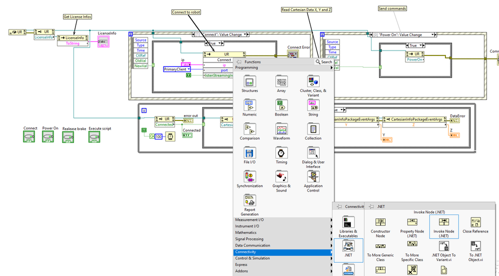

The LabView block "Invoke node (.NET)" allows you to call a function that remote control your robot.
As you can see, a lot of commands are available :
Add a call to a functionAdd a call to a function
Change a function callChange a function call
