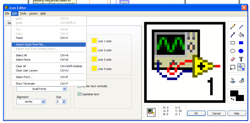

You can do it this way:
or you can copy the image and lick on the area that has the VI icon and clear that and past it in. I use ctrl V to paste in and it seems to always wok for me.

Or this way (I know this is not what you are after but it might be useful)

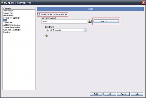

I was using the icon editor in the build specification:

When you open a project build specification, go to icon and click on the icon editor button, this is the icon editor you get.  I would appreciate if you would do it and tell me if you get the "old" icon editor, too.
Also, I think there is a misunderstanding;  I am not talking about the vi icon that you see on the front panel in the upper right corner.  I want to create the icon which appears with the exe file after building.

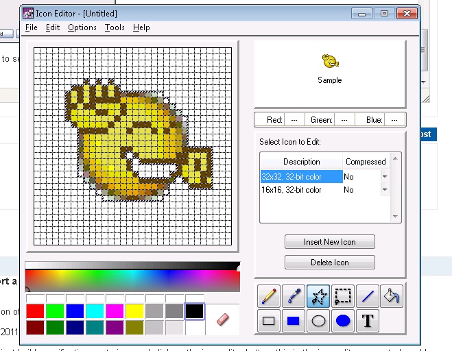

Hello David,
I was able to import an image to the executable icon editor( see image below).
Just open the image using windows paint, press CTRL+A to select all, CTRL+C to copy, then go to the executable icon editor and paste it. I did it with an emoticon:
Mart G
