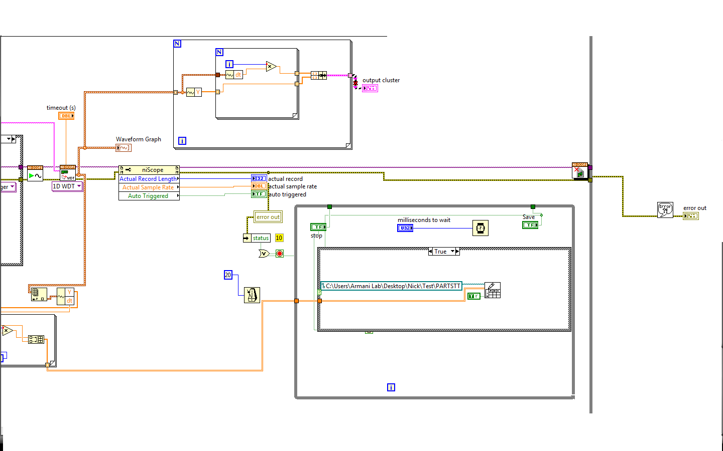

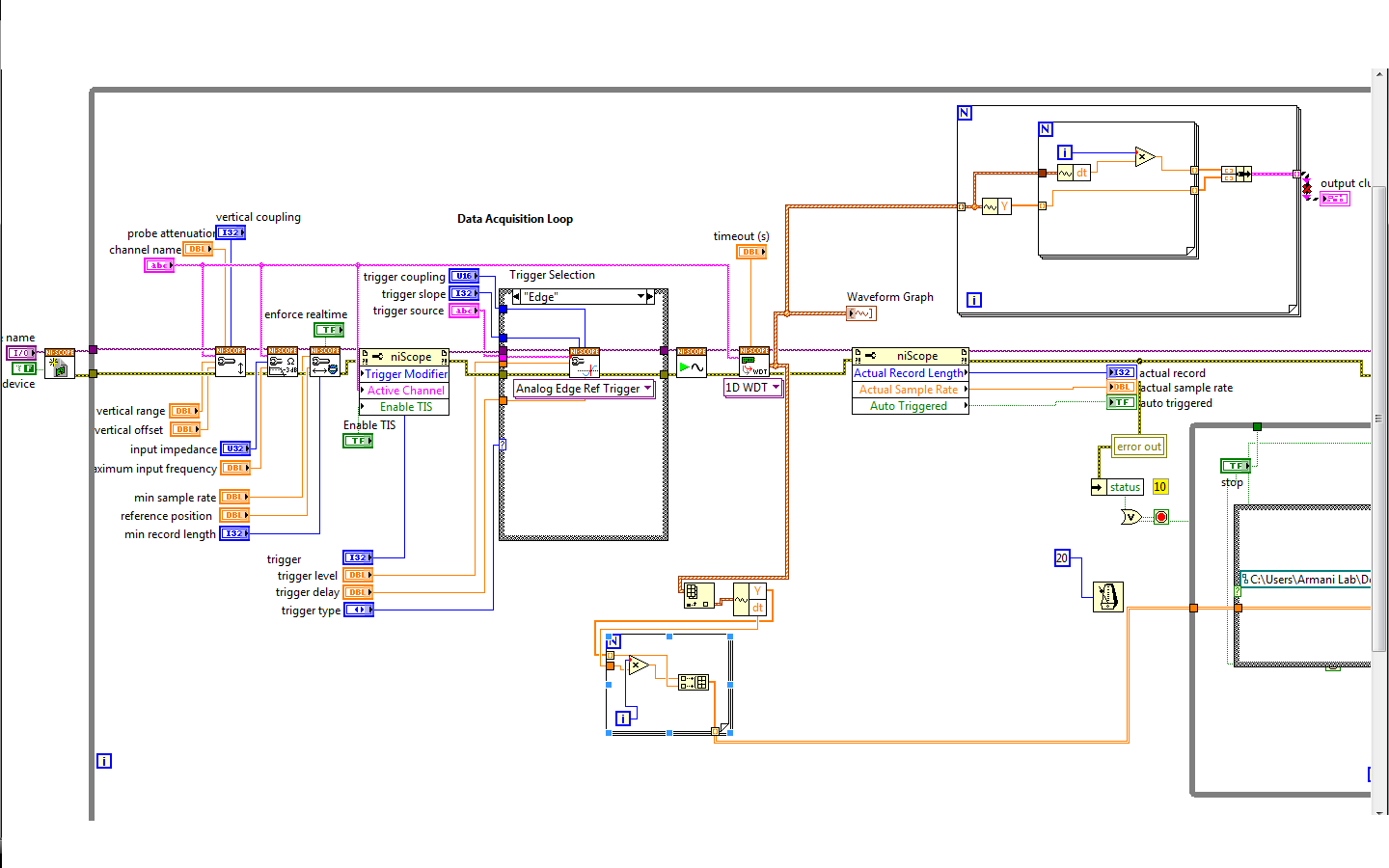

Want me to put up my whole Block Diagram?
Message 37 of 40
(2,077 Views)
Sure, that would help.

Haha, sorry for massive mess, I dont know how to shrink it...
Message 40 of 40
