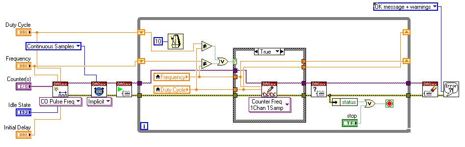

I have attempted to hook up the frequency into a shift register as well, and I was wondering if i could get some advise with regards to simplying or correcting my back panel wiring diagram shown here:

You only need one instance of DAQmx Write; it has inputs for both Frequency and Duty Cycle. Delete the additional one. Add an OR on the case structure condition - you want to execute the write if the Duty Cycle has changed, OR if the Frequency has changed.

I have updated my wiring diagram based off of your suggestion: http://i.stack.imgur.com/p9g4u.jpg
Is this what you were referring to?
If not, could you please comment?

I think that's the right wiring, but it's hard to tell since you show the false case where nothing happens. You could clean it up a bit by removing excessive wire bends and keeping wires running left to right.
No need to upload to a third-party image hosting site, the image hosting on this forum works fine and you can upload directly. Even better would be to attach your VI instead of a screenshot.

I have uploaded the VI as well as an image of the back panel.
Please let me know what your thought are.

Still some ugly wires (particularly the error wire that loops back under the case structure) but the logic looks fine. I'm not really sure what you're asking - are you still having a problem with it, or does it work as you expect? Did you test it?

I just tested it right now and it works perfecrtly using the diagram below:
I cleaned it up using the "Cleanup Diagram" button.  I uploaded the VI as well in case anybody else needs it.
