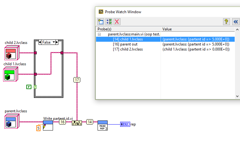

Inside this specific read vi I also want to have information about tdms path that is inside parent class, so I need to inherit this information from the parent. I'm having problems doing it. Please look at the png. After going to more generic class I'm still seeing child class with incorrect parent information.
I actually thought that I have to use parent class and cast it to more specific class (chosen child class) which gave me, obvious to you, error 1448. Can you also tell me why I can't use this casting here?

First the casting issue: You have to initialize the object to the child class AT THE VERY BEGINNING.  You cannot arbitrary cast a class into a child class.
Now for accessing parent's data: Create a Protected method in the parent to access the data.  By making it protected, only those who inherit from the parent can access it.

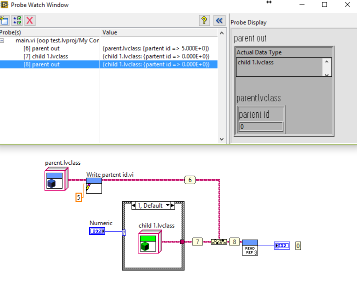

Hmm, that's interesting. I've initialized all the children classes and cast parent into one of them.
There is no casting error which is cool.
But why after casting am I still seeing parent class that is reading parent vi instead of child.
Shouldn't it be the child class in that wire from now on?

When you make the array of classes, they will automatically upcast to the common parent.  So when you put Child1 and Child2 into the same array, they are cast there into Parent.  Hint: look at the coercion dots.

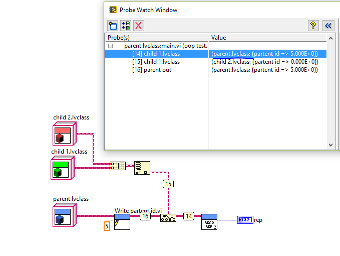

Can you tell me how can I choose, on which class I want to cast during the runtime?
This doesn't work either:
As I said, you cannot cast at runtime.  You have to initialize with the child class.  I do this with the Get LabVIEW Class Default Value.  You could also use the Get LabVIEW Class Default Value By Name if all of your possible child classes are already in memory.  Both of those return a class type of LabVIEW Object.  But since it initializes the class you specify, you can then down cast that to the child class, but you really just need to cast to Parent and let Dynamic Dispatch handle the rest.

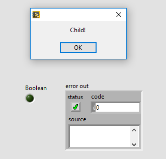

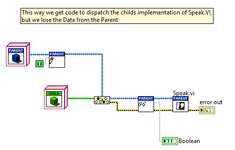

There is no way, to change the type of the class from Parent to Child during run-time? At least not without losing the Parents data?. In the following example the code will always execute the childs implementation of speak VI (which brings up a pop-up saying "Child!") but we will lose the Data from the Parent (boolean will be False):
And this is what the FP looks like:
I understand that I could initialize the whole code with the Child class and go on from there. But in my case i realized midway programing that I would need a child class.
Any answer would be greatly appreciated.
