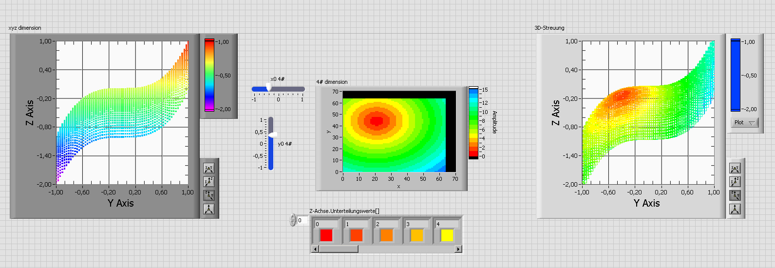

it is possible to programmatically customize a (vector) 3d scatter plot's color mapping:
http://forums.ni.com/t5/LabVIEW/How-to-display-4d-data-within-a-3d-scatter-plot/m-p/2508388#M763667

The thread that are linked in that thread have some code that shows how to use the 4th dimension as the color. So for your question that means reformatting your data properly and providing a color scale.
