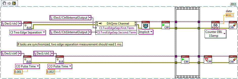

<rant>
However, personally I really don't like putting multiple counter outputs in the same task.  I have seen so many people assume that the counter outputs would be synchronized due to having them in the same task when this is not the case (you need to configure a start trigger in order to synchronize the counter outputs even if they are in the same task).  This is the only case I can think of where multiple channels in a DAQmx task are not automatically synchronized.
As an example:
Running this on my PCIe X Series gives a measured 2 edge separation of 1 ms + {7.78 us - 10.11 us}.  This would likely be much worse on a bus with more latency (e.g. USB).
The resulting output is close enough to what you might expect that it might go unnoticed, but really these counter outputs are not synchronized and it would be easy to glance at the code and not even think twice about it.  For the small amount of extra work on my end to create a separate task for each counter, it really clears up some ambiguity about what the counters are actually doing.  For me it's worth it.
So again, for your case there really isn't a problem with having the counters in the same task since you are using an external start trigger anyway.  I have just gotten in the habit of avoiding doing this.
</rant>
