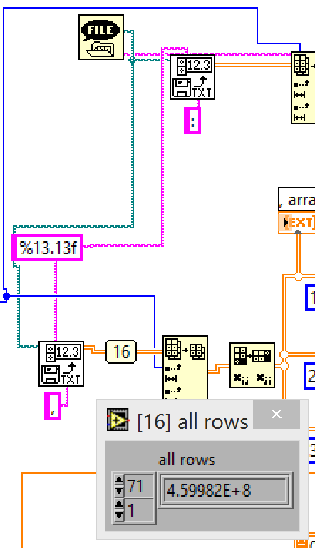

Unfortunately, no.  If I probe directly after the spreadsheet read, the data is coming in as SI.

That still looks ok.
What are your Display Format settings for your Array Indicator for your EXT Array?

The import format is irrelevant. All that matters is the display format of your array indicator. (As Ravens already said)
(Why is your array indicator EXT data type? that seems pretty useless since you import it as DBL)

The display format is set to floating, 15 sig figs. I know the data values past the decimal point are not being read since I am doing some simple math afterwards such as subtracting index N from index N+1 from an array of these values and it's returning zero as it's only after the decimal that is changing, and that has no value so the math ends up as X-X=0.
