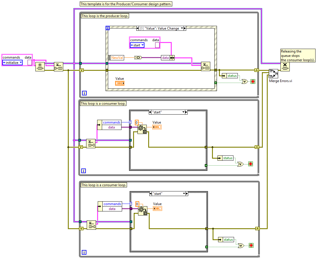

send it like this to multiple loops...."DATA/value IS DIRECT WIRE" to your input
Message 9 of 38
(4,826 Views)
Hi apok,
do you think it's a good example to dequeue a queue in 2 independent loops?
This will just force questions on race conditions...
Message 10 of 38
