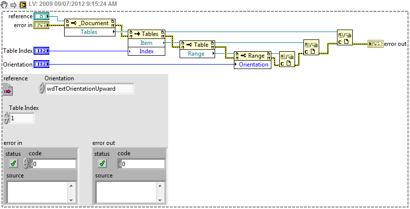

Previous post shows the constant values for Excel (my mistake). The following code will change the text orientation for a whole table in Word.
Ben64
