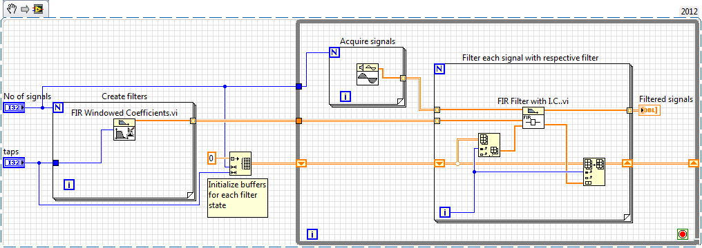

There are also two VIs which let you explicitly set initial conditions (mening the same as filter state): IIR Filter with I.C..vi and FIR Filter with I.C..vi. You can find them in Signal Processing -> Filters -> Advanced IIR/FIR. You can store the states and coefficients in 2D arrays. Here's general idea how should it work:
