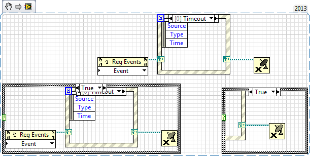

A quick example of the danger:
The same code was copied and dropped into each case structure.  One has auto grow Off.  A Merge vi (Drop vi contents from palatte would do the same)
While this proves auto grow isn't perfect (the case id overlaps the event border) at least the code isn't hidden
