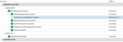

I've updated my labview to 2018 SP1, it seems that our develop license does not include continuous integration system. I would like to uninstall this package as everytime I launch labview, it asked whether I want to activate it.

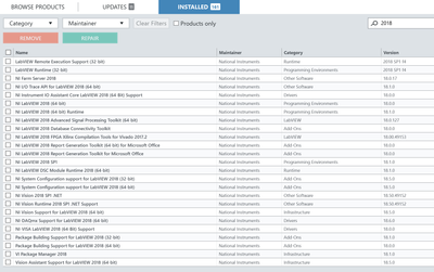

I tried to uninstall it from through uninstall->NI Package Manager, but I do not see this package there.
It does show up under my licence manager. How do I remove it or at least stop the nagging window asking me to activate it ? Thanks in advance

Not sure why you're even being asked to activate the software but you could probably try just removing the license from "<ProgramData>\National Instruments\License Manager\Licenses\". Just move the license out of that folder and you shouldn't be prompted to activate anything because there won't be any license to activate.
(3,182 Views)
Accepted by topic author marxious
Thanks ! I removed the LabVIEW_CIS_PKG_180001 from ProgramData\National Instruments\License Manager\Licenses
and the nagging window went away! huge relief. Thanks!!
