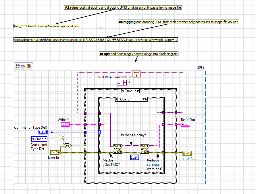

What's the difference is between dragging the png to the desktop then to the block diagram (that works) and saving the image to my downloads folder and then dragging the saved image file into the block diagram (that only pastes a link to the image file into the block diagram)?

Yeah, I can see now you can do it that way, but I never have my desktop visible (always running at least one program maximized - FF and/or Thunderbird (email) - even if behind other windows), so save-drag is more convenient.
I guess it's because the programmers of FF made a decision a while ago to NOT include all of the cross-program functionality of IE, because it can more easily get you into trouble if you run into malware on the web (or at least that was the story).
