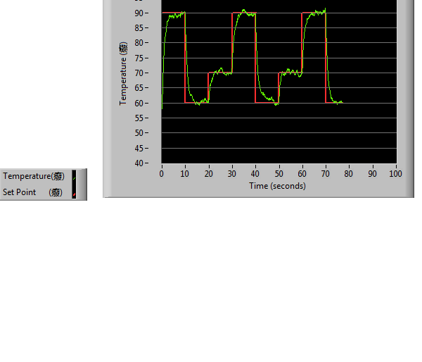

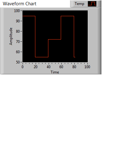

How do i add a graph behind my waveform .
How do i make a graph behind my waveform .
Example.

I understand about the multiple plots . but as you can see the picture . one is in wave form , one is square form .
