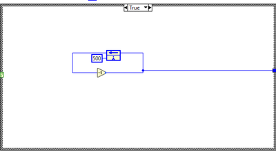

How do i reset a feedback node insade a case structure?
Hello, i have this problem: basically each time the case structure changes from false to true, i want the feedback node to start from 500 instead that from 0. With the feedback node in photo once the value has reached 0 the case structure changes to false, what i want to do is that when it goes back to true i want it to start from 500, how can i do that?
Thank you

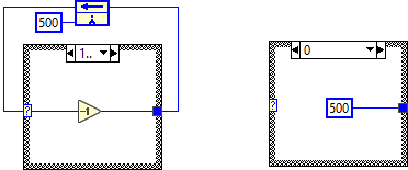

Tried but its not what im searching for, i need a function that, starting from 0, increments until 500 and then decrements back to 0, continuously
(2,276 Views)
Accepted by topic author domcorrado
With a feedback node:
