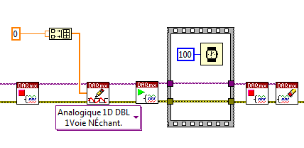

Here is what I do:
Running this with animated execution tells me that the "Sart Task" VI hangs a little and produce error 200946.
Looking at the forums for this error, I found this thread.
So, it seems there is no simple solution to send the AO to 0 after the execution of a VI. In my opinion, the default behavior should be to send all the outputs to 0 when the tasks end, but it's only my opinion...

Ok, I solved my problem by writing zeros on my output starting a new generation.
It's not really satisfying, but it works.
Thanks for the help !
