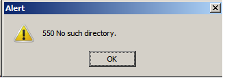

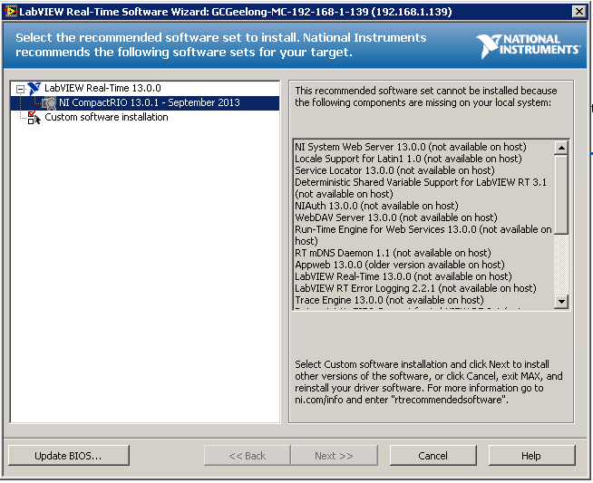

Does anyone know if it is possible to install labview 2012 onto a cRIO-9068?
See Attached:
This is after installing all of the LV2012SP1 Drivers for it.

Hi Timmar,
when the cRIO9068 was presented on the last NI event it was clearly told: It's a new device and new devices are supported by the latest LabVIEW version.
So the cRIO9068 is supported by LV2013. Older LV versions don't support newer hardware.
(Things might be a little different for DAQmx, but also here you have some deadlines for hardware support of older/newer devices and/or software support for older LV versions.)

Hey Timmar,
A document that I like to reference in regards to OS and RT Version on controllers is this,
What Operating System is my Real-Time Controller Running and Why?
http://digital.ni.com/public.nsf/allkb/35F1FD98520D6E0E8625783A005AF557
Our LinuxRT OS was released in the 2013 version of LabVIEW Real-Time. You can get some more clarification on which OS's ship with which module by looking at the corresponding readme for LabVIEW Real-Time 2012 and LabVIEW Real-Time 2013.

Timmar,
I think the link you were trying to use was this. This link can be found in the cRIO-9068 user manual. The manual points to an info code: rdsoftwarerevision. If you navigate to ni.com/info you can enter this code and it should point you to the page.
