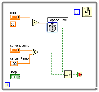

quick and dirty?
Kind regards,
- Bjorn -
Have fun using LabVIEW... and if you like my answer, please pay me back in Kudo's 😉
LabVIEW 5.1 - LabVIEW 2012

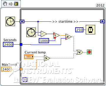

simple and sweet elapsed timer...
Spoiler
(2,900 Views)
Thank you for the help everyone!
