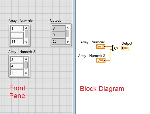

Hello ectoxmussel,
The numeric operator primitives are polymorphic and can operate on your arrays element-by-element if you provide two arrays containing the operands.
It's simple once you know that it works, but if you don't read the help for the primitives it can be overlooked pretty easily - I've definitely been surprised in the past by things like this that "just work"!
Hope that helps!

Accepted by topic author ecotoxmussel
You don't need to overthink it. There's a really simple method. Generate an array that contains all your offsets you want.  Then subtract it off.
It's the same VI with this change:
