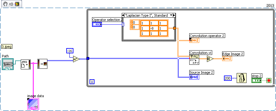

        I have using about three different methods but all of them jump to the error: not an image.
        1.using imaq to read file and using the imaq edge detection.
        2.using imaq to read file and using the built-in 2d convolution vi.
        (using imaq cast image amd imaq image to array to convert to unsigned 8 bit grey image)
        3.using read jpeq to read file and using the built-in 2d convolution vi.
        I have fight with it and try to fix it but in vain. And I don't know the reason what cause the error.
        How do I fix all of the version?

hi,
1# your input picture has a depth of 24 bits, so you have to wire the 24-bit output of "unflatten pixmap.vi";
if you don't wire the correct output, the resulting image will be empty.
2# you need only 8 bits for the "convolution.vi", so you have to convert from [0;1;2;...;(2^24)-1] to [0;1;2;...; (2^8)-1]  for example like this:

Thx, it helps me a lot and give me the reason what I make mistakes so that I won't make mistakes again.
I really appreciate your help!Smiley Happy

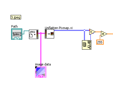

alternatively, you could use "scale by power of two" to convert from 24 to 8 bits:
