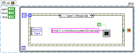

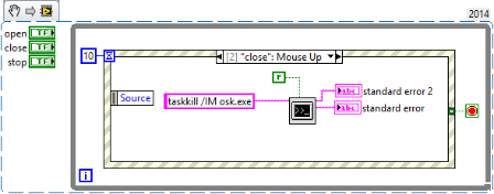

                     Here i've attached what is my pblm. Typically when i'm click an open button that (open system keyboard)osk.exe automatically it                                opens and finally when i'm click the close button that command prompt says error.
                     ERROR:The process "osk.exe" with PID 3340 couldn't be terminated.
                     Reason: Access is denied. (cmd prompt says it)
                     Soln: If i'm open that .exe file as an system administrator permission(through CMD prompt) that ERROR wouldn't come.
                     Restriction: I've to open that file with system administrator permission(throughCMD prompt).
                     Is there any soln to clear that error?

Can you attach a real snippet (or preferably the actual VI) instead of a picture of a snippet?
Pictures don't show sufficient information, e.g.
Why are you using "Mouse up" events?
What is the mechanical action of the booleans?
What's in the timeout case?

OSK is the On Screen Keyboard developed by Microsoft for Windows XP (I believe).  Searching the Web for it shows numerous posts (having nothing to do with LabVIEW) where people are having trouble invoking it.  Given that, you may be (and probably are?) encountering an issue with using software not really "ready for Prime Time in Windows 7/8/8.1/10" (I presume you are no longer running Windows XP).
Taskkill is another Windows XP command.  How it interacts with UAC is anyone's guess.
It is probably better to do whatever it is you want to do by some other means, preferably ones that are more LabVIEW-centric and rely less on hooks into the Operating System.

The timeout case does NOT do anything. Delete it. Why do you use the "Mouse up" event? Just use simply the "Value change Event" for the buttons.
Change the mechanical action of the buttons to "Latch when released" from the "Switch until released". (https://www.youtube.com/watch?v=lvm3B2cLO90 , https://www.ni.com/docs/en-US/bundle/labview/page/changing-the-mechanical-action-of-a-boolean-object...
About the functionality: I tested your VI, and it works for me, the on screen keyboard starts. I have Windows10 x64 OS. However, the taskkill part does not function.
Edit: But why you need to launch this Win app from LabVIEW? You can just access it from Windows itself. What is your goal here with this "on screen keyboard"?
