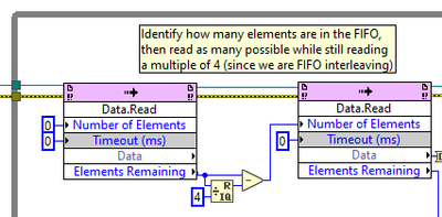

The shipping example is correct.
When reading back from the FIFO, the host is always returning data in a multiple of 4.

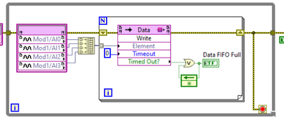

But that is exactly my point!
1. The FPGA reads the 4 channels, and then writes them to the FIFO Block in loop.
2. For the waveform, every dt value for AI0 should be 1/(2000*4) since it has to read the other 3 channels before can it get back to AI0!
(2,228 Views)
The channels are read simultaneously; each channel has its own ADC. Not sure I understand your question.
(2,219 Views)
